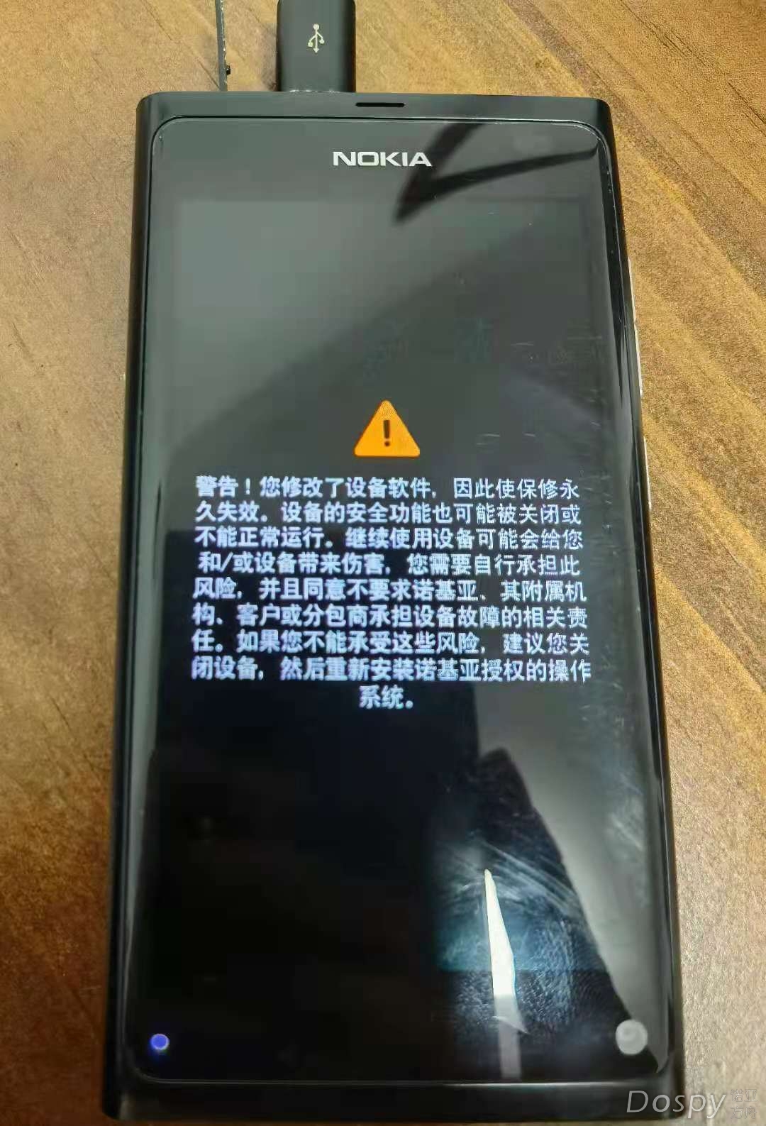

刷机失败了,开机出现这个图片,还有救吗?
以下是日志
C:\Program Files\Nokia\Flasher>flasher -F 123.bin -f
flasher 3.12.1 (Oct  6 2011) Harmattan
WARNING: This tool is intended for professional use only. Using it may result
in permanently damaging your device or losing the warranty.
Ping attempt 1 (250 ms)
Server application: 1.7.2
Found product RM-696 rev. 1508
Server implements softupd protocol version 1.8
Image SW version DFL61_HARMATTAN_40.2012.21-3_PR_003
Image moslo not present
Image mmc not present
Image tar skipped
Image config skipped
Battery level 64 %, continuing.
    image        [state    progress         transfer     flash speed]
[x] cert-sw      [finished   100 %       1 /       1 kB      NA     ]
[x] cmt-2nd      [finished   100 %      95 /      95 kB      NA     ]
[x] cmt-algo     [finished   100 %     789 /     789 kB      NA     ]
[_] cmt-mcusw    [finishing   25 %    6050 /    6050 kB    3386 kB/s]
[x] xloader      [finished   100 %      23 /      23 kB      NA     ]
[x] secondary    [finished   100 %      94 /      94 kB      NA     ]
[x] kernel       [finished   100 %    2714 /    2714 kB    2477 kB/s]
[_] rootfs       [init         0 %   32768 / 1188233 kB      NA     ]
ERROR: SU_GET_UPDATE_STATUS_REQ terminated with error code 1: Unknown error
[x] cmt-mcusw    [finished   100 %    6050 /    6050 kB    3386 kB/s]
[f] rootfs       [init         0 %   32768 / 1188233 kB      NA     ]
Fetching error list:
Update content failed to verify against cert: SW certificate not updated
bb5_rdc_cert_read failed
mmc: sfdisk returned status 1
mmc: Could not exec 'tune2fs -L rootfs /tmp/sudmmcL1WLlv/internal0p2'
mmc: Could not remove mount directory /tmp/sudmmcL1WLlv/mnt: No such file or directory
[Pipe   4] Finishing in error state with status 1
ERROR: Failed to flash images
